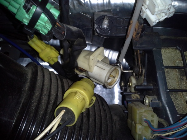

In the process of pulling my ECU I discovered a reason my speedo might not work. Some of you might recognize a mechanical speedometer cable when you see one. For those that don't, I think you can imagine it doesn't belong by the blower on the passenger side. Let's just pretend somebody was REALLY anticipating a JDM RHD conversion.

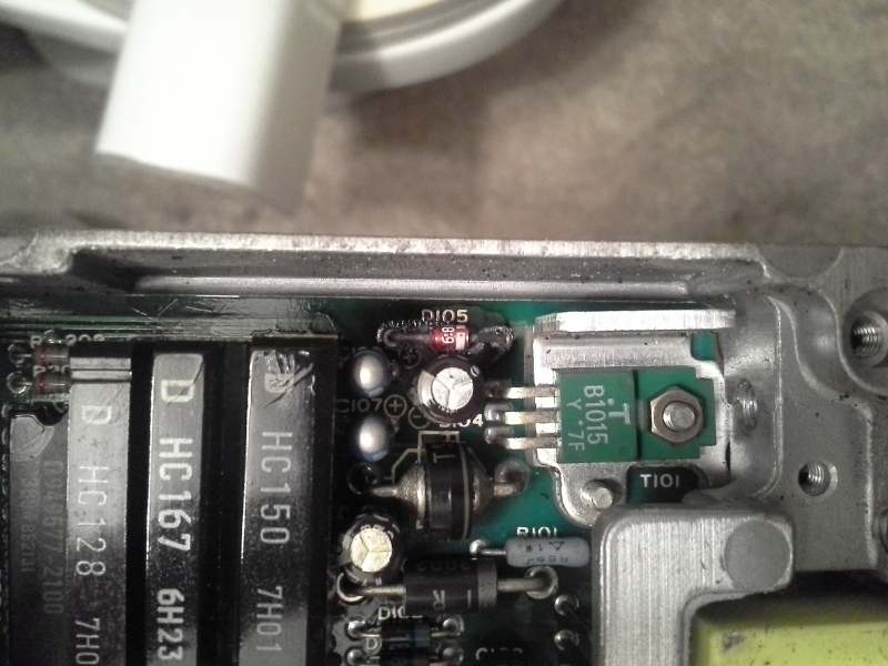

This poor diode is in the voltage supply circuit.

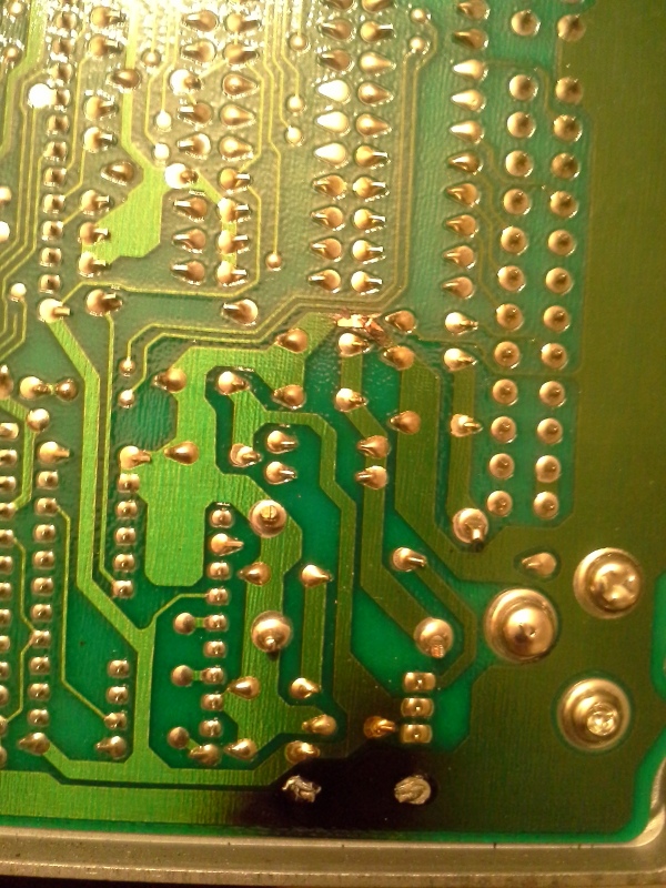

Underside of it, also notice the small trace near the middle of the pic that almost burned through.
Even if I hadn't popped it, here are some corroded transistors that need cleaned up.
I can probably fix this but will buy an ECU from GZero if I can due to time

Here's a mystery for super electronic nerds. What is THIS thing. Has no markings other than the green stripe, just 2 pins. There is also one with a red stripe. They are labeled "J" which is normally a jumper but I've never seen one of these. I think the crustiness is just a poor quality casing.

Today I discovered a team of angry squirrels at the command of my right foot! That's right... I fixed the ECU!! Garage Zero didn't have an ECU compatible with my engine so I went to work on fixing my own. Fry's had the diode I needed but there was a capacitor I couldn't fully spec because it was so tiny. John had a scrap ECU for some other Toyota from which I salvaged a cap that looked the same.
The car needs a thermostat and idle adjustment but otherwise it fired right up and runs AWESOME!
